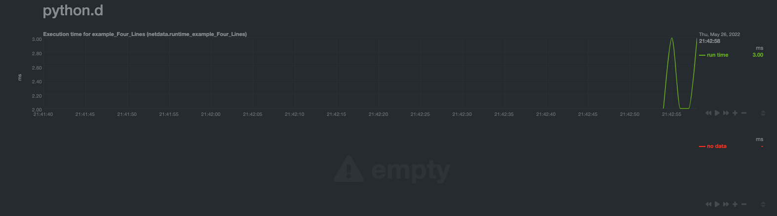

  1. The dashboard python.d section contains an empty chart:
