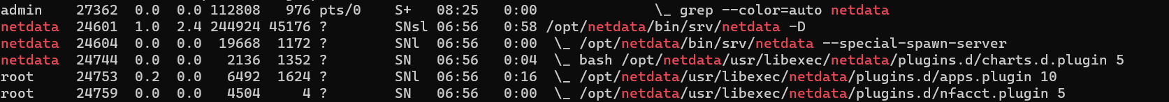

Is your netdata installed under /opt/? Can you ps faxu | grep netdata?
Hi refer to the screenshot
I installed it in the /opt directory. Weird that out of nowhere my error.log balloon up and my raspberry pi that has a limited storage for tracking start to sends notification of out space. I usually check the storage and the error.log causes it in which I need to reinstall the netdata to fix it but is there a way to truncate the error.log while netdata is stop and start it again after truncate?
