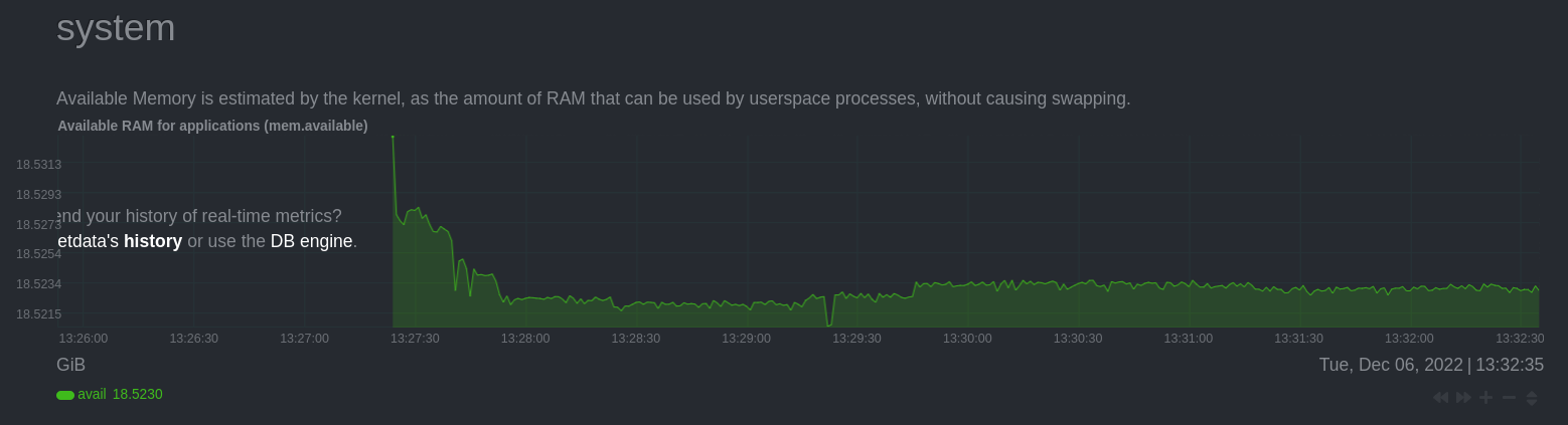

We provide LXD VPS hosting and we have a couple of hosts that use various version of LXD. Initially, we thought it was because of LXD incorrect values of available memory are shown. So we installed Netdata on all hosts that have a different version of LXD. But irrespective of the LXD version, incorrect values are shown.
So, we instead started downgrading the Netdata version. We went all the way down to v1.33.1, and with this version, the value is shown correctly on the hosts where we previously saw incorrect values.
Is there something we’re missing or is this in fact something to do with Netdata?
Please see the attached screenshots.
With the latest version of Netdata on server with 20GB RAM:
Using the v1.33.1 on the same machine (shown correctly here):
Please let me know if you guys need more information - happy to provide it!
Thanks.
Hi, @philip. The avail value comes from /proc/meminfo
$ grep MemAvail /proc/meminfo
MemAvailable:   15396028 kB
The only additional processing we do with the value is adding (if available) ZFS ARC shrinkable cache size. See this PR (appeared in v1.35.0).
Can you check /proc/meminfo?

We see the correct value. Here’s output from meminfo:
MemAvailable:   19212896 kB
And we indeed use ZFS but why add ZFS ARC cache to mem available? It’s not usable RAM, right?
avail 70.47
It means that ZFS ARC cache shrinkable size is ~50GB (zfs_arc_max - zfs_arc_min).

  • Yes, Netdata is installed directly inside a container (LXD Ubuntu Jammy)
  • No. We want to monitor the container, not the actual host it is running on.
Basically, we installed Netdata in a LXD Ubuntu container and we want to monitor it. Not the actual host.
Usually, this can be achieved by not mounting the host system procfs/sysfs inside the container . I assume you didn’t do it, but /proc/spl/kstat/zfs/arcstats exists and returns the same statistics as it would if you were reading it from the host system.
It is not clear from the Netdata view that those metrics don’t really belong to the host (LXD container). I guess a quick fix is disabling both ZFS collectors:
[plugin:proc]
        /proc/spl/kstat/zfs/arcstats = no
        /proc/spl/kstat/zfs/pool/state = no
I am not sure what would be the proper solution (some additional checks based on what? the current logic is straightforward - if there is a file and it is readable - read). In general, taking into account ZFS ARC cache when calculating ram usage/mem available is correct (common sense, htop does it).
Ok, I guess I know what we can do.
htop src code:
   if (lpl->zfs.enabled != 0 && !Running_containerized) {
      // ZFS does not shrink below the value of zfs_arc_min.
      unsigned long long int shrinkableSize = 0;
      if (lpl->zfs.size > lpl->zfs.min)
         shrinkableSize = lpl->zfs.size - lpl->zfs.min;
      this->values[0] -= shrinkableSize;
      this->values[3] += shrinkableSize;
      this->values[4] += shrinkableSize;
So they do this only when NOT containerized. The fun fact that I was aware of the check (fixed container detection) but somehow forgot to implement that in Netdata :see_no_evil:
@philip can you share cat /proc/1/mounts? I want to see if this check is enough. I can test only in an LXC container.

The same issue is on GitHub. I think I understand what is happening.
Fixed in fix(pacakging): fix cpu/memory metrics when running inside LXC container as systemd service by ilyam8 · Pull Request #14255 · netdata/netdata · GitHub
