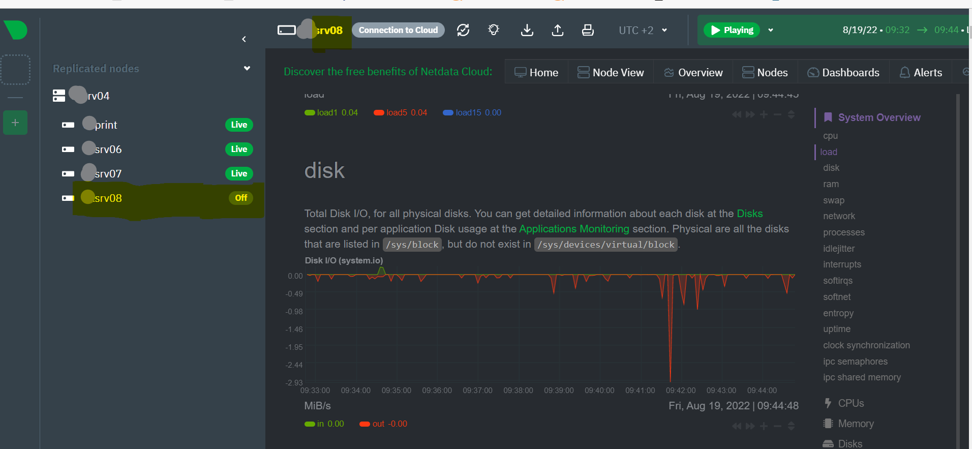

I have set up streaming from clients to a parent node. Everything seemed ok until one client suddenly shows as “off” in the node list. The odd thing is that it is still sending live metrics and they show on the parent dashboard as they should.
What can be wrong and how do I remedy this?

Odd thing is this:
  • if I turn off srv08, then srv07 also shows as “off”
  • if I then also turn off srv07, then srv06 also shows as “off”
  • if I then also turn off srv06, then print also shows as “off”
