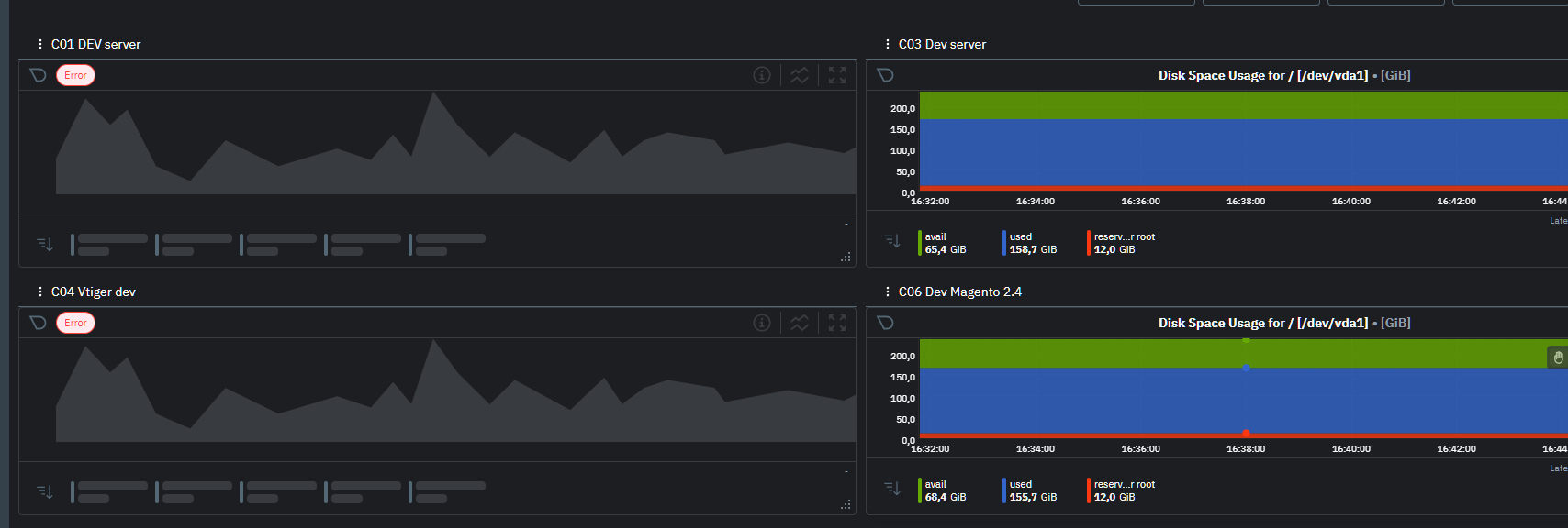

dashboard charts not showing data before visiting node
Problem/Question
I tried to make a dashboard in the cloud-ui for monitoring my available diskspace on each node and it showed i nice and tidy :slight_smile:
after logging in the next day i opend the dashboard only all the charts loaden without data and a error banner in their top left corner.
if i click on the option for a chart in the dashboard en go to chart and then go back to my dashboard that specific node chart gives data again.
Environment/Browser
agents on centos 7
cloud on a windows machine in a chrome browser
What I expected to happen
i hoped i didn’t have to visit each node every session do make sure my dashboard wil show any data.
the funny thing is, this problem does not happen dt my dashboard with chars of each nodes cpu_load.
does anyone have an idea why this is happening on a diskpace chart
Hi @wiziekid ,
Could you help me confirm my understanding of the the scenario your are facing?
  1. Go directly to the dashboard created, you don’t see any data on charts and the Error badge on the top left corner of each chart.
  2. Then go a the disk space usage chart on a Singe Node tab, e.g. the on for the 003 Dev server chart
  3. When going back to the dashboard you see the data and no error on the charts you did the above, if you did it only for 003 Dev server you would only see that.

Hi @hugo ,
you are completly correct in your description of the scenario. :slight_smile:
i’ve checked the console an found a bunch of errors. i incuded an export of the console log from chrome at the bottom.

Hi Dennis,
Thank you for providing this information.
Will analyse it and pass it internally and share an update as soon as I have some more details.
Regards,
Hugo
hi @wiziekid!
The issue has been identified internally. A new bug report has been filed and we are working on a solution. Thanks for bringing this to our attention!
Best regards,
Kostas
Thanks :smiley: i hope it will help you improve this already amazing product even more :smiley:
Hi @wiziekid ,
We’ve released a fix for this bug that was tracking your issue [BUG] Error in charts in custom dashboards when user does a fresh log-in · Issue #264 · netdata/netdata-cloud · GitHub
Definitely! Keep sharing issues/bugs you might have as well as ideas.
If you aren’t there yet join our discord server, check this post Netdata now has a Discord server!
Regards,
Hugo
hi @hugo
that’s amazing, do i need to do anything to make the dashboards that where not showing data work? of should they work now?
kind regard
Dennis
You will need to remove the charts with the issue and re-add them, there was an issue when the configurations for these were stored.
Sorry for the trouble.
