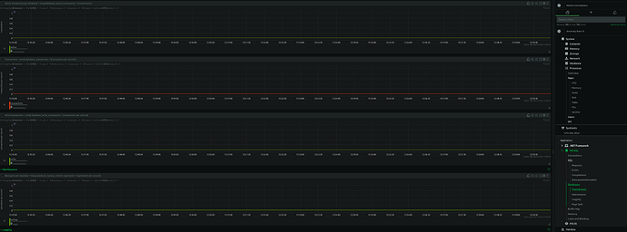

  2. Install Netdata Using the Latest MSI Package:
    After removing the exe version, download and install Netdata using the latest MSI installer. This will automatically make the data available, as shown in the screenshot below:

Hi! I have installed the latest windows agent. I see some MSSQL metrics but all transactions metrics are zeroed. Is that expected on the current version?
Hello
I have also installed the latest version and the transactions and active connections in MSSQL metrics are always at 0 even in production environments, which doesn’t make sense.
Has Netdata team considered to improve this in the next versions?
Hi Thiago
We have installed the latest versions of Netdata and the transaction metric in MSSQL is empty or always zero (0) for all database of instance including production environments. Is something missing in the configuration?
